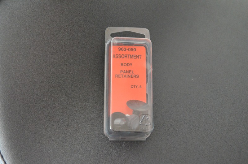

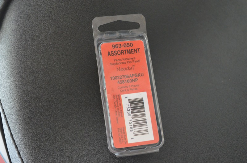

This is laughably simple, but a few people have commented on how clean it looks. In light of that, I figured I'd share. For those who aren't looking to spend money on plates... Available from your local auto parts store. You'll need two packs of the assortment shown below: Dorman 963-050. Total cost will be less than $10 after tax. Say goodbye to hitting your heels on the passenger pegs!

Same results with Balkamp p/n 665-1000 at NAPA Auto Parts. $5.99 14 pcs.

Excellent! I was just getting ready to post this topic as I had not seen this on here. I went to the parts store and dug through all they had and found Dorman brand part number 963-004D. They are smaller than those above - actually slightly smaller than the factory bolts - they are a snug fit - and color match is perfect.
