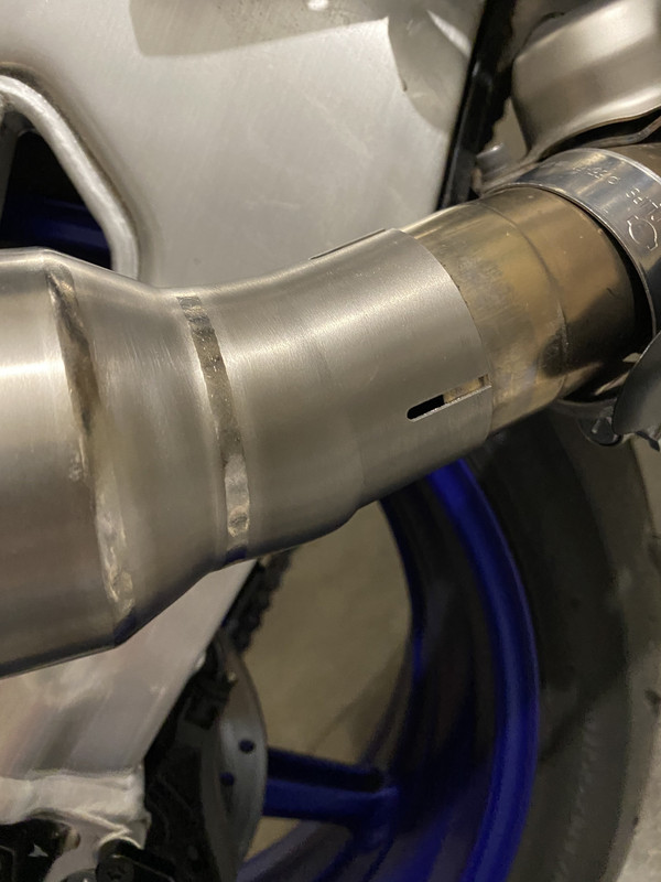

Hi All, Just received my brand new austin exhaust and I've got a question. I can't push the silencer further than this: Is it problematic? Should it be pushed all the way in? Thanks ! 🙏

Hi All, Just received my brand new austin exhaust and I've got a question. I can't push the silencer further than this: Is it problematic? Should it be pushed all the way in? Thanks ! 🙏 It does need to slide on further. Gunna have a major leak if not!

I have a different set up but issue was the same. It's no biggie. Bend those inlet areas that are cut out very slightly. It will slip on and the clamp will squeeze them snug once its tightened. Got 0 leaks.

so just push it until the holes are not to be seen ?

Yes it needs to be inserted more so that the holes are fully covered.

Yes it needs to be inserted more so that the holes are fully covered. ok perfect cheers !
